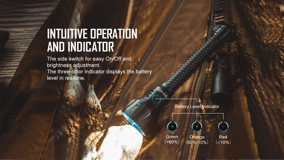

Question 4: How do I determine the remaining battery power of the product?
Answer 4: The indicator at the center of the side switch clearly displays the batter life with a green(>60%), orange(10%~60%), or red color(5%~10%).

SIDE SWITCH
Press and hold the side switch to turn the flashlight on or off. When turning on, the brightness level is memorized as the last output selected when the light was turned off via the side switch.
When turning on, single click the side switch to change modes. Single click the side switch to cycle through the brightness levels. Starting from the present brightness,the output brightness will enter the next high brightness according to the preset order. When the output is in Turbo, single click the side switch to enter the low mode (15 lumens).
