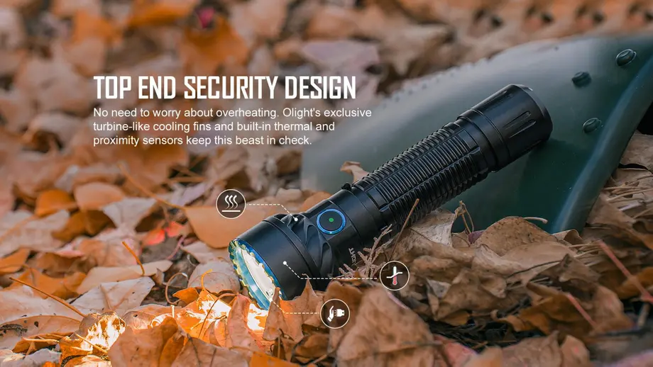

Question2: What have we done based on flashlight safety?
Answer2: A light sensor is installed inside the lens. When the flashlight is working in high brightness, if the front of the lamp cap is blocked,which is in order to prevent the flashlight from lighting up automatically in the pocket, and prevent clothes from igniting automatically as temperature is too high, or the opposite strong light source (such as direct sunlight, street lamp, strong light flashlight, automobile headlamp, etc.) which will cause loss of vision, the brightness will automatically decrease. When the obstruction is removed or the opposite light source disappears, the brightness will be automatically restored.
Question3: Why doesn't my flashlight fade automatically?
Answer3: Water, dirt or scratches on the lens surface may cause the failure of the internal light sensor. Please keep the lens surface clean.
Question4: Why does the brightness of the white light decrease when it is used with silicone cover?
Answer4:When the flashlight is used in conjunction with the silicone cover, the silicone cover will reflect light, causing the light sensor works, so the white light can only work at the low level.
Question5:Why does my flashlight sensor doesn’t work sometimes?
Answer5: It depends on the sensing distance. And there are differences in the sensing distance of flashlight due to the different materials and surface colors of the objects (in the range of 3 ~ 50cm). The higher the reflection rate, the farther the sensing distance.
Question6:What’s the difference between side switch and tail switch?
Answer6: The side switch can turn on both white light and colored light, but the tail switch can only turn on the white light.
Question7:Is it dangerous to continue using the flashlight when the battery power is going to running out?
Answer7: There is no potential risk when the battery energy reduced (the indicator light is orange or red), but the output brightness will weaken. In this state, the light sensor will stop working and the output won’t be decreased due to obstruction or the opposite strong light.
